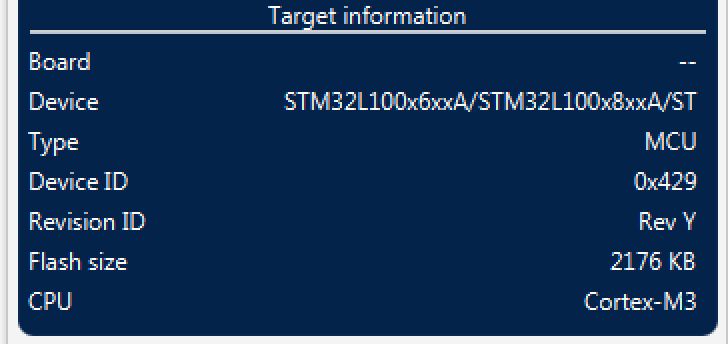

Now, if I open the STM32CubeProgrammer v2.1.0, open the same file RAK5205_Blink.hex, the ST-Link v2 is recognized and connected correctly, read the memory of the MCU without problems, but when I want to program it in the same way than before, it shows the error, "Flash loader can not be loaded".
What is the difference between the ST-Link Utility and the STM32CubeProgrammer regarding device detection and programming?
What exactly does the error"Flash loader can not be loaded" means?
One difference I noted is that the STM32CubeProgramer, detected the Device as STM32L100x6xxA / STM32L100x8x ... with a Flash Size of 27520 KB instead of 128KB that has the MCU, different from what it is detected with ST-Link Utility.

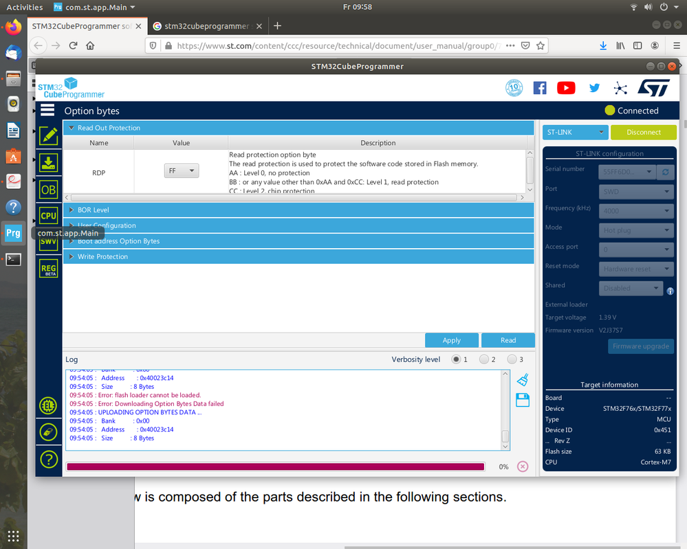

In the Terminal "LSUSB" I find "ID xxxx:xxxx STMicroelectronics ST-LINK/V2". Some pages from the STM32F767BI are readable. I already install the latest linux driver for the ST-LINK/V2 version 1.0.3-1 from the packet en.stsw-linl007_V2-38-27.zip (other versions are windows only).
2021-05-25 7:05 AM
Still no sollution. They mention on google about st-link utility but this is integrated in the STM32 IDE.
Can someone help me out, if I run the IDE it gives the result below:

Memory Programming ...
Opening and parsing file: ST-LINK_GDB_server_lSOXfX.srec
File : ST-LINK_GDB_server_lSOXfX.srec
Address : 0x08000000
Erasing memory corresponding to segment 0:
Erasing external memory sector 0
Error: failed to erase memory
Encountered Error when opening /opt/st/stm32cubeide_1.5.0/plugins/com.st.stm32cube.ide.mcu.externaltools.cubeprogrammer.linux64_1.5.0.202011040924/tools/bin/STM32_Programmer_CLI
Error in STM32CubeProgrammer
Debugger connection lost.
Shutting down...
