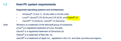

Hello @remes-mymi and welcome to the ST Community.
As mentionned on the release note of the last version of the STM32CubeProgrammer, the version supported of Fedora is the Fedora 37:
Best Regards.

2024-11-04 1:00 AM
Hello @STTwo-32, thank you for your answer.
Are there any plans regarding support for Fedora 41? Can I provide any assistance?
In the meantime, I will be using alternative solutions, since I cannot downgrade to Fedora 37.
