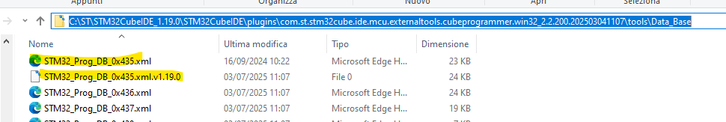

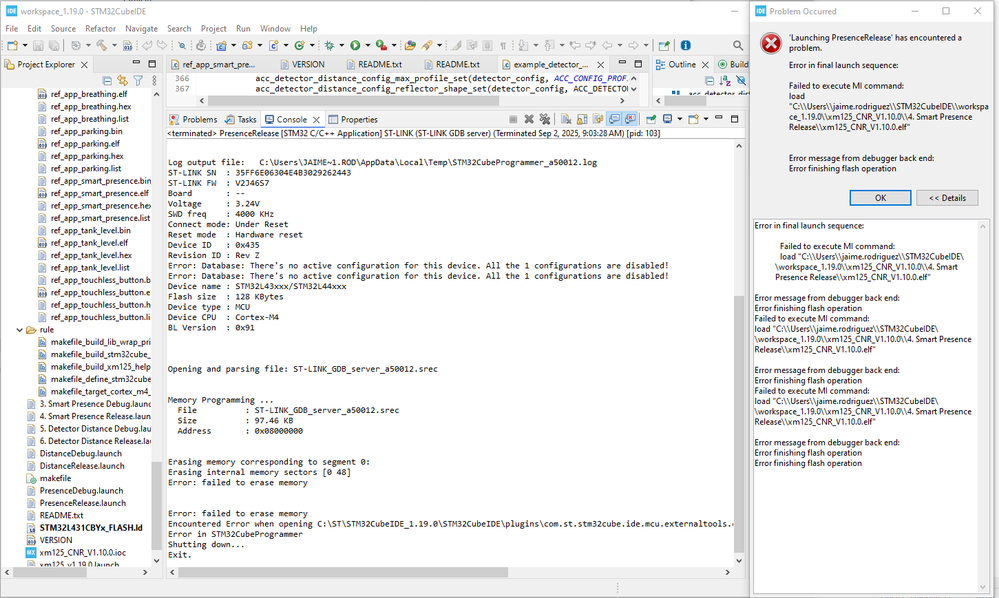

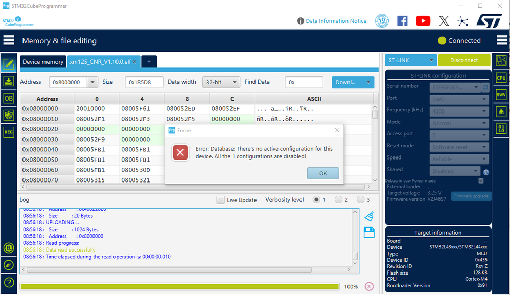

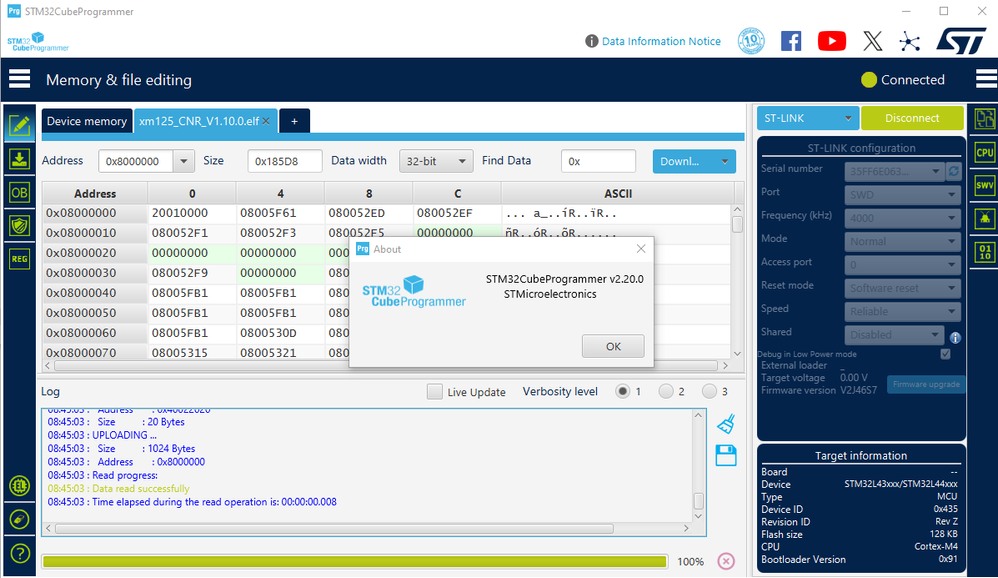

2025-09-02 12:23 AM
This is a big problem.
I'm currently having the problem with both versions: STM32CubeIDE v.1.19.0 and STM32CubeProgrammer v.2.20.0 for the STM32L431CBY microcontroller. See the images below.
Could you please suggest a solution as soon as possible? As you can understand, we have deadlines, and this issue has been pending for months!
Would it be better to downgrade while you investigate the issue? Or use and replace the XML database with a previous version, as one user mentioned above?
In any case, could you offer an alternative solution in the meantime?
Thanks in advance.
