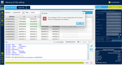

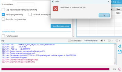

this is the message I get when I want to connect to my device
(you have the Device ID at the bottom right)
This is the message I got when I want programming
This is on version 2.18
When I replace the XML file from version 2.17 in version 2.18, no more problem
Sébastien

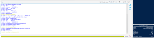

Hello @COSEBE ,
Thank you for your feedback.
I tried connecting an STM32H735 (same Device ID 0x483) and downloading a firmware using version 2.18.0 but couldn't reproduce the issues.
Could you please also provide your option bytes configuration? Thank you in advance !
Maryem.
