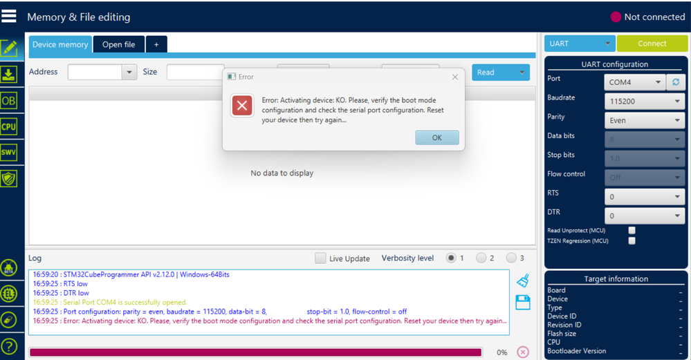

@Javier Muñoz I already have a COM port. I can communicate with the device via putty, tera term or similar serial terminals.
I haven't fully implemented open bootloader yet. However, at this point whenever I try to connect to the device via stm32cubeprog it throws the following error.
In addition, I am not sure what baud rate to set. I don't think the baud rate is applicable to Bluetooth connection. In putty, communication is okay irrespective of the baud rate.
I would try it with the factory programmed bootloader first
Thats a good question, i would try 115200 as it is standard.
Perfect then
