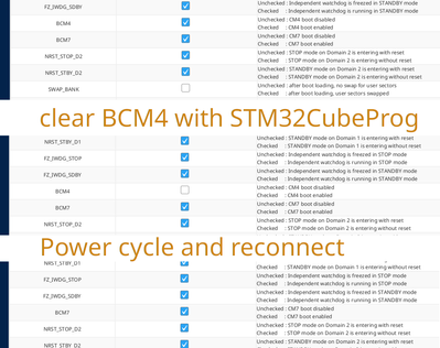

2025-02-26 11:15 PM
It happens with STM32CubeProg too:

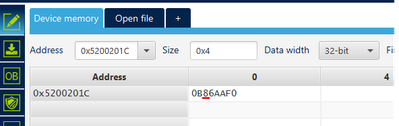

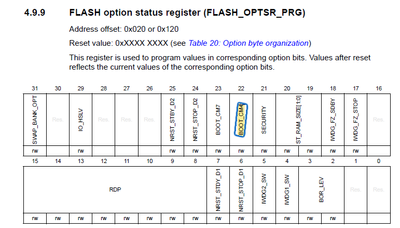

After applying the the new option byte configuration go to the device memory and read the content of the registers
FLASH_OPTSR_CUR and FLASH_OPTSR_PRG:
FLASH_OPTSR_CUR located at the address 0x5200201C
FLASH_OPTSR_PRG located at the address 0x52002020
For example this is a screenshot of my FLASH_OPTSR_CUR reading:
8 means the CM4 is disabled. C means CM4 is enabled.
If you find that the reading of these registers corresponds to what you set in the option bytes, this means the option byte were physically correctly set and there is something went wrong in CubeProgrammer.
2025-02-27 9:51 PM
So I write it by SW and it works as far as I can tell, but CubeProg hides the setting (only if CM4 boot is disabled and a power cycle has been done) in the OB tab.
PS: Did I forgot to mention that BCM4 reappears in CubeProg when I enable CM4 boot OB by SW.

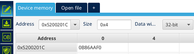

2025-02-28 12:27 AM
Do you confirm when CM4 boot is disabled, the register contains 0x0B86AAF0 and when it is enabled it contains 0x0BC6AAF0?
I want to be sure that the bit is effectively written.
2025-02-28 12:30 AM
Yes
