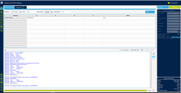

2024-08-27 1:47 AM
Hello @Jin454 ,
I tried connecting an STM32C031 and the device ID is correctly displayed on my end.
Could you please try reading data at @ 0x40015800 as shown below and let me know the value?
Thank you in advance,
Maryem.
