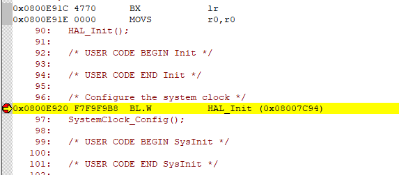

Previously debbugging started at "HAL_Init()" like it should when user application was <48kb
But now, when user application is >50kb it starts debugging at some kind of wrong address:
0693W00000DmsNMQAZ.png It does not hit "HAL_Init()" anymore like it should.
Why user application size could impact that? Or it could be some kind of different issue?
How could I fix this?

Use STM32CubeProgrammer to verify the contents of the flash. If they match, the error is in your program and not the bootloader. Otherwise, the bug is in your program. You can step through to see where it goes wrong, possibly the stack is overwritten, or a memory allocation fails.

I have verified that flash is correct, currently I dont use bootloader to load the application it is loaded with keil to 0x08004000 up to 0x0801005D0. Could this be some kind of issue when the app goes to 0x08010000?
I cant step through the program, because it does not jump to the start of it, when I remove some C files it jusmps to HAL_Init as it should, I will try to remove different C files, and maybe will try to confirm if its application size or those C files are the issue.
Currently I dont use bootloader to load the application it is loaded with keil to 0x08004000 up to 0x0801005D0. So it should erase correctly. Also I have erased flash with STM32 Link utility and flashed bootloader and application, but if I try to debug application with Keil it does not hit the start of the application it jumps somewhere else. Could this be some kind of issue related that the application spans over 0x08010000 address?

Indeed, it seems that the issue is in this line:
void CheckBytes(uint16_t bytesToCheck)
  uint16_t bytes = MIN(64, bytesToCheck);
  uint8_t buffer[bytes];
My heap is set to 0. Does dynamic array allocation in function uses heap instead of stack? I thought it uses stack?
Still I would expect application crash once it hits this code? But it should not execute it on application start.
I have changed this code:
To this:
  uint8_t buffer[64];
And now application runs without issue. So it seems it had issue with dynamic array creation. But this code should not run on the start off the application. why it crashes on the start? Does this code requires heap memory?
