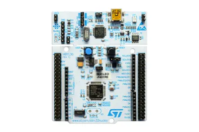

@Alberto4 wrote:I am using the development board STM32F446RE .
That's the name of the chip - not the board.
So what board is that chip mounted on?
eg, is it the NUCLEO-F446RE?
https://www.st.com/en/evaluation-tools/nucleo-f446re.html
2024-04-11 2:19 AM
Sorry. Yes, I am using the NUCLEO-F466RE board.
