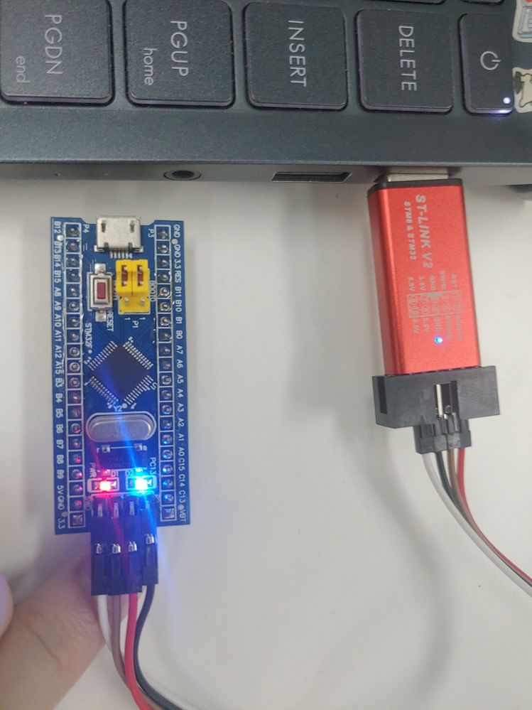

Sorry this is neither ST’s board (blue pill most probably with a contrefit chip) nor an ST’s ST-link (copied ST-Link), I cannot help you.

Provide a picture of you setup: your board, the cable connection…
2024-04-10 11:25 PM - edited 2024-04-10 11:28 PM
Sorry for late response
