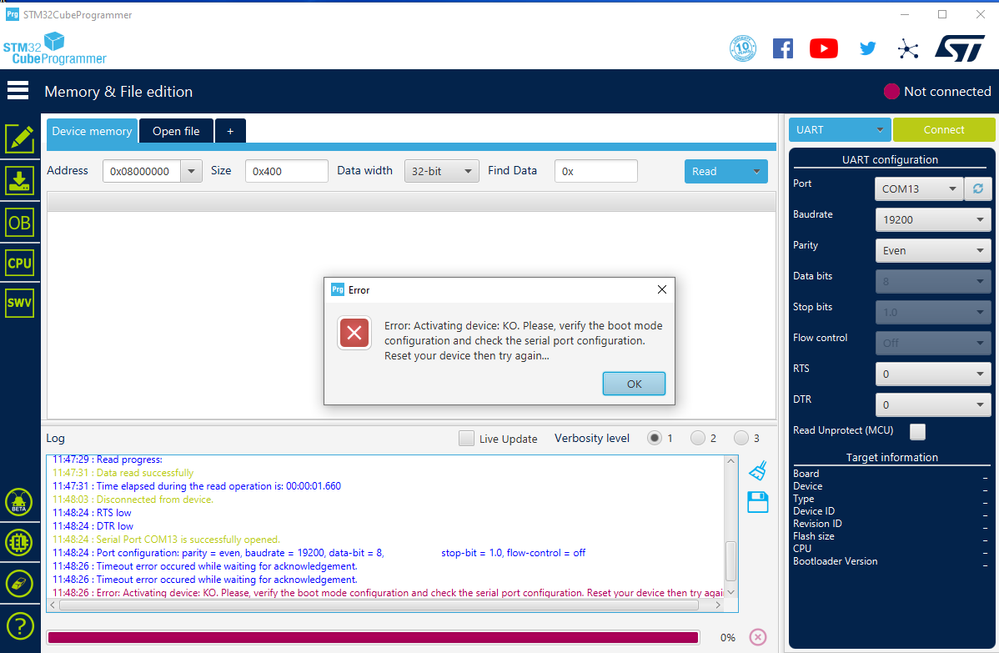

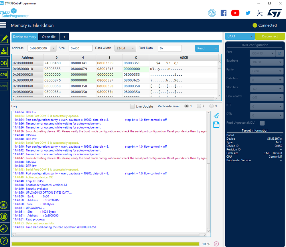

BX R0 When I power cycle and try to connect via STM32 CubeProgrammer, I get below error:
But when I press Reset button on STM32H745-DISCO, then connection is succesful without any issue
I am wondering what's the difference between pressing reset button and power cycle.
Any advice on how I can fix the issue.

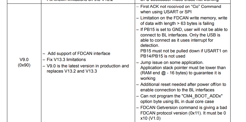

2022-10-20 3:54 AM
The STM ROM bootloader present is V9.0 and seems there is a know bug with it
"– Additional reset needed after power off/on to enable connection to the BL interfaces"
Is there any workaround for this?
2022-10-20 6:14 AM
Field programming, probably don't use the system's boot loader, but rather your own, using some protocol supported by standard/common tools?
