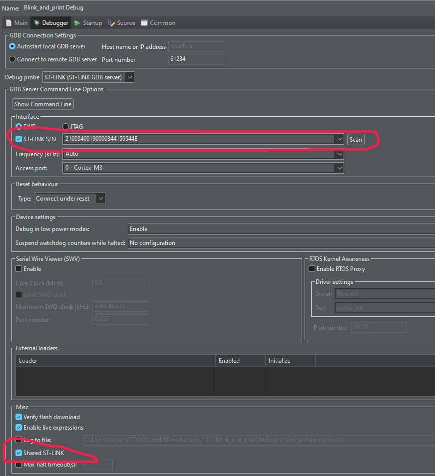

I have the same problem, my fake STLink V2 has only the ! character as a serial number. I think STM32CubeProgrammer will not work with a device without a reasonable serial number BUT the STLink Utility does; you can download it here: https://www.st.com/en/development-tools/stsw-link004.html it's not as capable as STM32CubeProgrammer but is OK for uploading/downlaoding firmware. Also as others have pointed out if the SHARED option is enabled in STM32CubeProgrammer and the REFRESH button clicked a serial number then appears and the fake device will then work with STM32CubeProgrammer, but only after upgrading the fake device firmware using STLink Utility - note any message about the device not being in DFU (Device Firmware Upgrade) mode just unplug from the USB socket and replug.
2023-12-03 4:50 AM
Further to my last post I can confirm that fake ST-Link V2 devices can also be detected and work with CubeIDE if the Shared ST-Link box, hidden away at the bottom of the Debug Configuration, is ticked. My fake device has a Geehy MCU, not CKS or STM, but it does accept genuine STM firmware upgrades although it still displays the single ! character serial number - so maybe it's a hardware design issue - I don't know?
