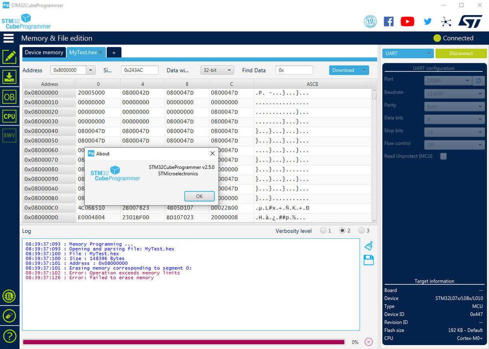

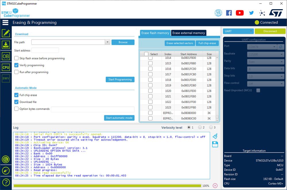

I think there is something wrong with erase. In the "erase flash memory" tab the "last" start address is 0x801FF80. With that there will be nothing erased above 128k

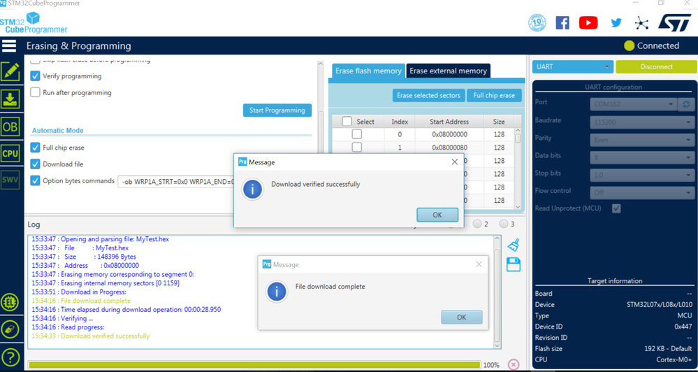

As I asked for answer, I got one: No problem, it has been tested with 192kb sample hex.
Only thing I can do now is to give a failing hex file. So if you feel like share it...

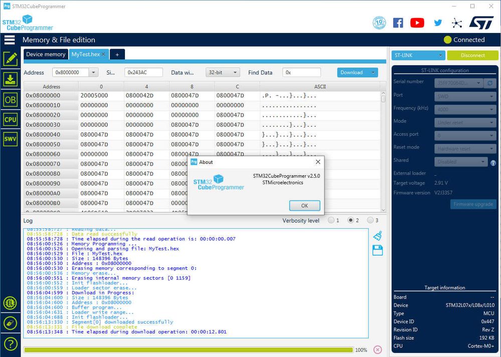

When programming same file with ST-Link it works just fine.

STM32L081CZT6
2020-09-25 1:55 AM
Exactly, STM32L081CZT6.

Tested with 192KB samples with CubeProg 2.5.0 and no issue found.
We are able to program with exactly the same file size as the customer with both ST-LINK and UART interfaces.
Please specify the ID of the Bootloader version.
