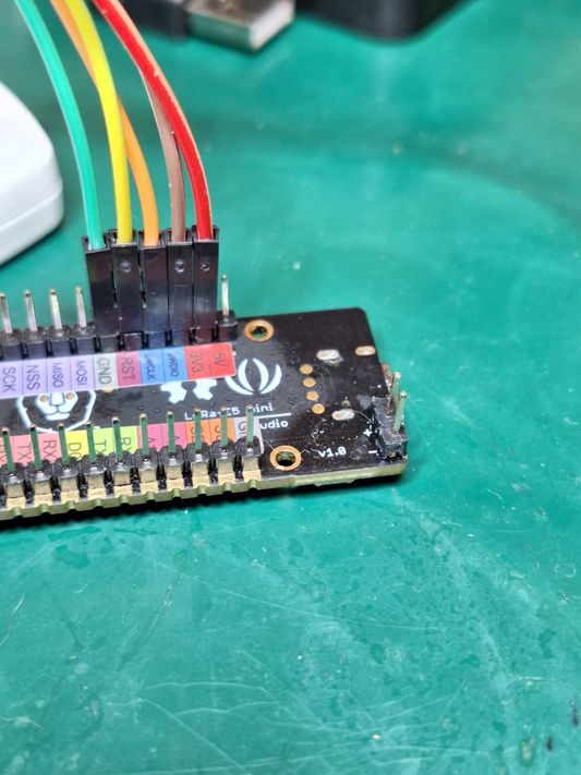

I have used the last working pin connections between ST-LINK/2 device and the WIO device, and for now, I'm a little bit closer, I think.

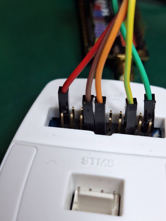

2026-01-17 11:45 AM - edited 2026-01-17 11:46 AM
Pins look connected properly. ST-LINK/2 VCC pins are 1 & 2. GND is the green cable.
I have used such connections earlier.
Do you see something wrong?
2026-01-17 12:03 PM
ST-link V2 giving no power...VDD connection is just for measuring the target voltage.
So give some 3v3 to the ...target. st-link will show then this voltage.

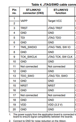

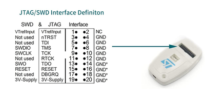

2026-01-17 12:08 PM - edited 2026-01-17 12:11 PM
...if this is correct: pin 19 giving 3v3 , pin 1 is for checking the voltage (this it shows then)
from manual:

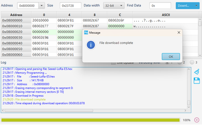

So I pressed the reset button on the device, and having pressed it, I pressed the Connect button on the IDECubeProgrammer, and voila, it works now.
And I was able to reprogram my WIO device.
