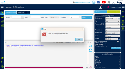

I attached my microcontroller to USB as usual (under W10). As you can see, I use SWD. But the programmer doesn't see it.

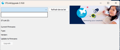

I can't upgrade the firmware because of it:
There is no item on the list

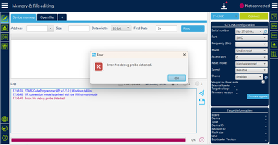

And I see that the programmer doesn't see the device because of that:
I need the right ST-LINK driver installed. Who knows what I should do to achieve it?
2026-01-17 10:11 AM
It's the same configuration that has worked under W10. The only change was from W10 to W11.
As you can see, there is no target voltage, and the LED doesn't blink when attached to the USB.
