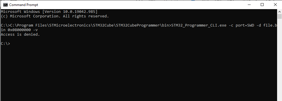

2021-05-21 3:48 AM
2021-05-21 4:03 AM
Hi @Dalhe.1
Can you please copy the STM32CubeProgrammer folder under any user folder (Desktop for example) and try again?
Houda
2021-05-21 4:11 AM
Hi @Houda GHABRI
I have just tried and it's always the same error.
