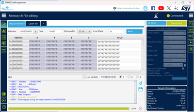

- connect via cube programmer UI, make sure to use "shared" probe, connection works:

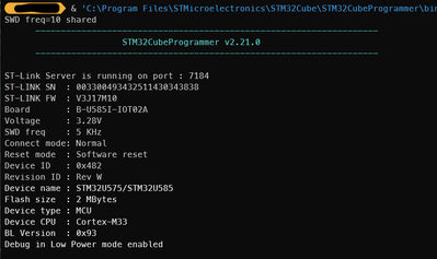

- connecting to the same stlink server via command line does also work:
`& 'C:\Program Files\STMicroelectronics\STM32Cube\STM32CubeProgrammer\bin\STM32_Programmer_CLI.exe' -c port=SWD freq=10 shared`
So the linkserver seems to work locally.

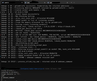

Same experiment as above, but running STM32_Programmer_CLI from a Docker container:
`/opt/st/stm32cubeclt_1.20.0/STM32CubeProgrammer/bin/STM32_Programmer_CLI -c port=SWD freq=10 shared`
But the port is accessible:
That means, the linkserver's port is accessible inside the container via telnet, but cubeprogrammer searchs for a connected device (via USB?) first and exits, before the remote connection is used.
