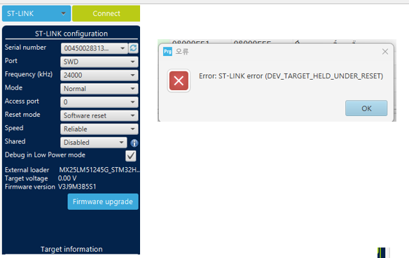

(The target board also continues to operate normally)
Symptom-1) The settings are the same, but the DEV_Target_Held_Under_Reset error suddenly occurred.
The configuration was operating normally, and even after changing all the things that could be changed, such as the target board, cable, and PC, the error below continued to occur.

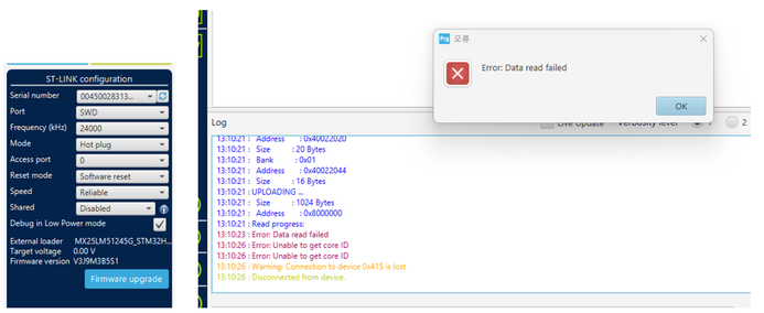

Symptom-2) When I changed the mode to Hot Plug, the connection was made, but a data read failed error occurred.
Since the data read failed error occurred, I could not perform any functions such as download and erase.
