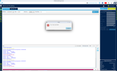

An issue appeared while testing the system bootloader, we wanted to perform a full flash erase to reset the chip as factory, but it became unresponsive.

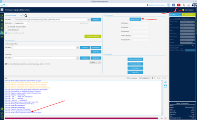

When connecting it to the STM32CubeProgrammer, the flash memory cannot be read, and when trying to read FUS version or to interact with it, it fails.
Full flash erase shouldn't have done this. What may have caused this?

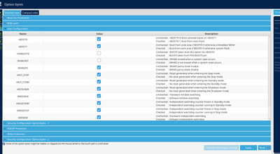

Could you please send a screenshot of the values of your option bytes? Also, are you using the STM32CubeProgtammer V2.19.0 or an older one. If it is an older one, please make sure to try using the last version. Finally, please send a photo of your ST-Link.

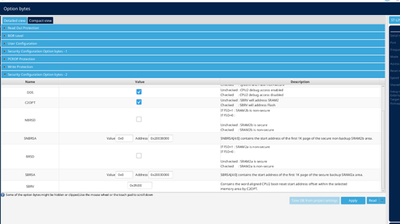

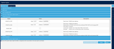

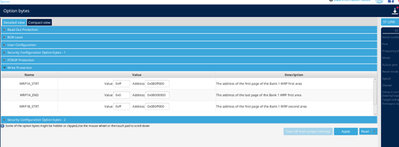

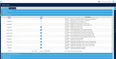

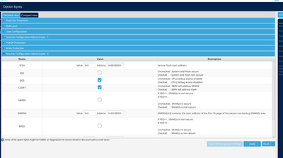

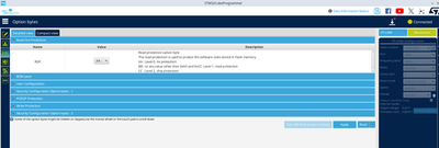

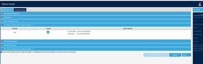

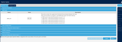

Here IS an image of the option bytes:
For erasing the flash we used the version 2.18, but we tested with the latest and got the dame result right now?
Is there any test that we can do in order to see if the chip answers?
EDIT: added more photos of the option bytes
2025-05-15 8:14 AM
Please send a screenshot of all option bytes.
Best Regards.
STTwo-32
2025-05-15 11:51 AM
I added all the screenshots in the previous post, so they are altogether.
