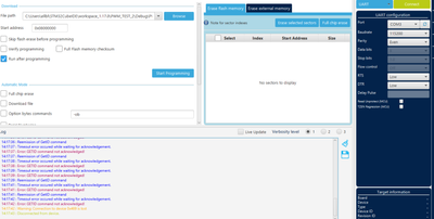

I am currently trying to program a nucleo board using USART. For this I am using the bootloader and Cube Programmer.
I first developed a program and tester it by programming via st link. My program worked with no problem. I then tried to program using UART.
I was able to connect but as soon as I started programming, I get the message Error :GETID command not acknowledged and then the nucleoboard is disconnected.
Here are my settings and the boot0 pin is tied to 3.3V.
When I program I can see on the oscilloscope that some part of the program is on and working but not fully as well.
Any idea ?
Thanks very much

I've tried both 9600 and 1200 bauds but it doesn't change a bit.
And I've tried using Real term but it doesn't seem to work either.
I've checked with one of the example to use USART via hyperterminal and that seems to work.

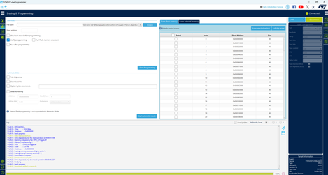

2025-05-23 3:54 AM
The bootloader protocol version is 3.1 if that's what your asking for.
I saw a slight difference between your settings and mine which is that you didn't check the "run after programming" box. I tried to program the nucleo without the box checked and there was no problem. But as soon as I pressed the reset button I got the same problem as earlier.
So the problem might come from my code.
I've attached the binary file I'm programming onto the nucleo.
Thank you

2025-05-23 4:14 AM
Here is all the informations :
I do get both messages :
- "download verified successfully"
- "File download complete"
And after both messages are closed does the error message appear.
2025-05-23 4:42 AM
Ok, I don't know why I never checked it, but despite the error message, the program appears to be working.
I tried with the example GPIO_IOToggle and the led turns on and off as it is supposed to...
The reset buttons seems to be working but only once out of every 10 times I press it.
