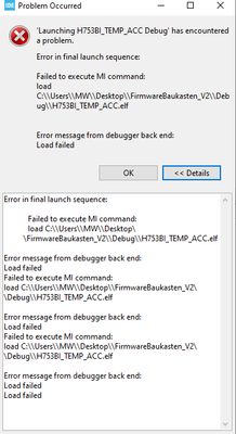

I encountered a problem while debugging my program.
CubeIDE Version 1.14 , CubeProgrammer Version 2.9.0, ST-Link Version V2J43S7
The ST-Link/V2 is found. You can erase the Chip (STM32H753BIT6) but can't download the .elf file (CubeProgrammer).
In the CubeIDE you can't debug but the ST-Link and the STM32-Controller is found.
We tried following steps:
The error:

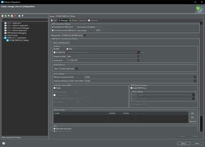

The debug configurations:
If you have any idea...

Could you try downloading the elf file with STM32CubeProgrammer as standalone application.
Also could you try to change the GDB server port number (increase it by 4 at least)

2024-01-15 10:48 PM - edited 2024-01-15 10:50 PM
I tried downloading the elf file with the STM32CubeProgrammer.
It did not work.
Also changing the server port did not work.
Have you any idea why?
Thank you very much
