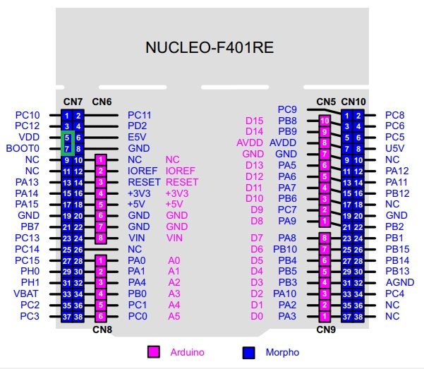

I would suggest you try strapping the VDD and BOOT0 (BT0) pins together so I doesn't run the user code, and try and come in with the ST-LINK Utilities to recover the device. Try the mass-erase options, and the option bytes. If you can't read the options bytes the device is likely locked out.

Thank you for your help! I tied to put VDD and BOOT0 together + ST-LINK Utilities, and didn't work, in these days I'll try Segger's recovery method, hope that it will work, otherwise i'll get a new board from my colleague.
