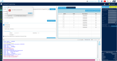

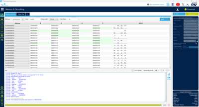

Hello @mƎALLEm, Thank you for your reply.
I have confirmed the Boot_XIP.hex is flashed on my board.
I then flash the GPIO_IOTOGGLE_Appli.elf file and receive this error.

From this screenshot we cannot see what you upload as file:
If you download the application with CubeIDE what do you get?

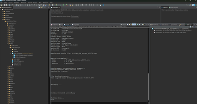

In CubeIDE, when I debug I currently have this error.
Debug Configuration is setup as mentioned in the README.md matching the photos I previously posted.
