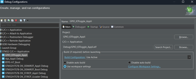

> Is there a way to change the address so we can explore the example projects?
Yes, in the debug configuration.

Thank you both for your responses. I walked through the instructions on the readme and was still struggling to get the project to flash. With some more forum surfing, I did find this instruction helpful.

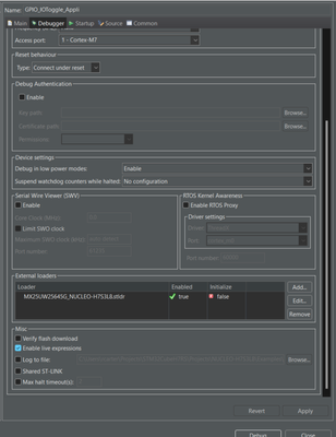

I have followed the instructions in the readme, and I am still unable to debug/flash my nucleo board. Could you please advise to what step I may be overlooking or any settings that are incorrect? Thanks
2024-12-20 3:32 PM

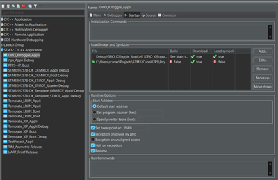

@potatobandit On your 3rd screenshot please note the "Start Address" box. This allows you to specify the start address. Probably you want to start running from the bootloader in internal flash (0x08000000).
2024-12-20 4:24 PM

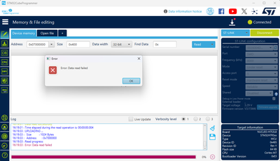

I updated the Start Address for "vector table" to be 0x08000000, same issue. The application's .map shows the _FLASH_BEGIN is set to 0x70000000. I tried using that value as well, as that aligns with image in the ST Forum example. This address however cannot be read.

I have cloned the ST Repo for the STMH7RS, performed the Debug Configuration, as the README has specified, then attempted to debug/flash the NUCLEO board. I either gets errors that the elf cannot be loaded or that the memory address cannot be accessed. I've tried these steps on multiple example projects in this repo.

Hello @potatobandit ,
Did you erase the internal Flash? in that case did you Upload Boot_XIP.hex file located under Projects\NUCLEO-H7S3L8\Templates\Template_XIP\Binary?
You need to Flash that hex file the boot part of the application executed from the internal Flash which configure the external memory interface and then handover the execution of the application to the CPU (execution from the external memory.)
