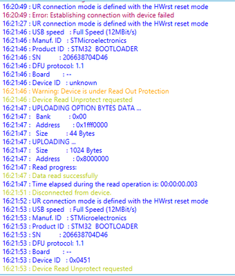

When connecting with "Read Unprotect", it cannot (sometimes it does) upload/read its DeviceID and OptionBytes.
It seems something to do with unsynchronized state machines of the internal F7 bootloader and CubeProgrammer.
The system seems to be quite unstable.

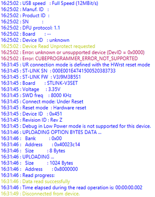

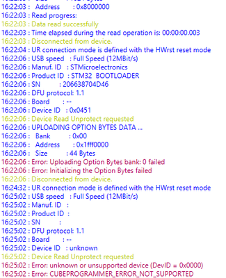

2025-07-31 12:00 AM
Example with USB FS with issue device ID
Issue with option bytes and device ID.

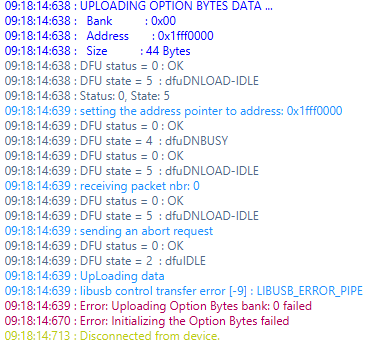

2025-07-31 12:21 AM
it has something to do with LIBUSB_ERROR_PIPE. Could not find sufficient info about this. If somebody can provide this would be nice.
