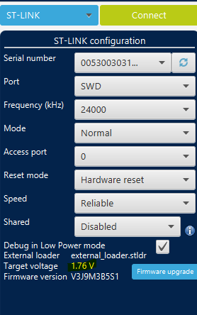

I also noticed that the target voltage (1.76V) after having the issue is lower than expected.

If voltage droops when you try to program flash, probably the power supply for the board is insufficient, or there is some other design error. Can you share the schematic?

No, the voltage does not drop only during the writing operation. On the CubeProgrammer interface, I can see the target voltage after powering on the board and before connecting; it shows a value of 1.76V.

If voltage drops *at all*, or otherwise not at its intended level, that's not something the software is going to be able to fix. If 1.76V is low, what is it supposed to be? Likely that's the source of your issues.
