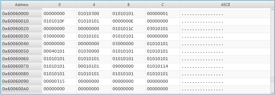

This follows shows the original data I want program at address 0x60060000 and the log generated during the programm procedure.

# Check the content of buffer where represents the content of 0x60060000. Has an invalid data 0x997dccd9b != 0x00000000.
0x20044f00: 0x997dcd9b<LF>
Programming at 0x60044634<LF>
Programming size:149040<LF>
Pointer Buffer 0x20029534<LF>
# Check again the content of buffer where represents the content of 0x60060000. Has an invalid data 0x997dccd9b != 0x00000000.
