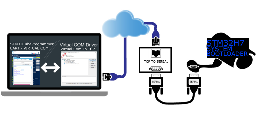

I ran system bootloader, I can perform the bootloader process using the STM32CubeProgrammer software via USART. But what I want is to run the bootloader software over TCP or UDP using the USART protocol. Because my UART2 line is connected to a TCP converter.
I wrote a piece of code using Python, but it's very slow and disconnects after a while. Is it possible to enable STM32CubeProgrammer to communicate with UART protocol over TCP?
Softwareally, I used TCP to Uart converters, but STM32CubeRogrammer is getting a time delay error.
My system is as follows;

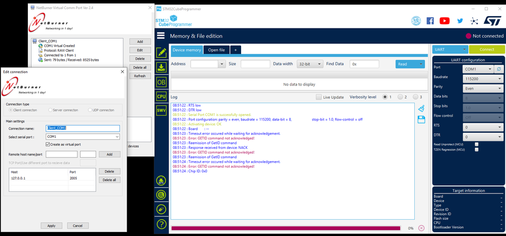

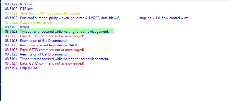

I was try NetBurner Virtual Comm Port Ver 2.4, however, this gave a time delay error (Timeout) like my python script.
I need more long time for waiting for acknowledgement.
How can I increase the acknowledgement wait time?

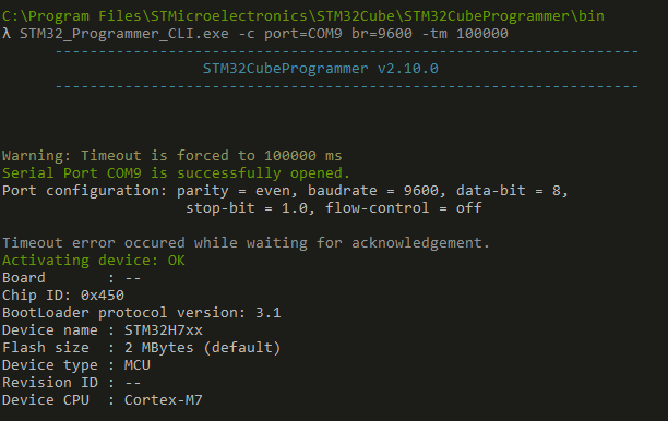

I propose to test this, hope it resolves the issue :
STM32_Programmer_CLI.exe -c port=COM36 -tm 100000
STM32CubeProgrammer v2.10.0-RC2
Warning: Timeout is forced to 100000 ms
Serial Port COM36 is successfully opened.
Can you please test it and tell me if it is OK ?

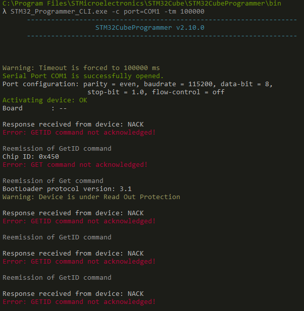

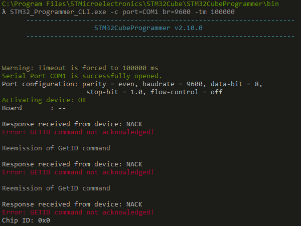

2022-03-30 5:32 AM
Hi @Houda GHABRI
I'm sorry for the late reply,
Timeout error persistsi, this method is not ok
I'm working over TCP;
I do decrease the Bauderate value over, there is a timeout error (Over TCP)
İf direct connect to system bootloader (STM32H7 UART-2)
