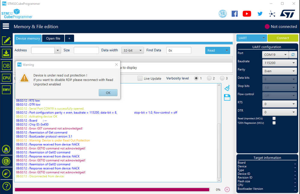

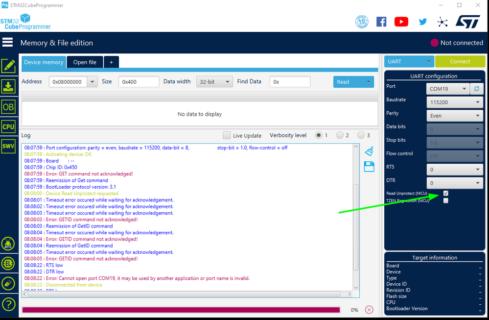

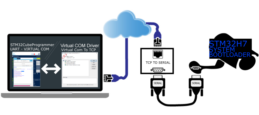

I ran system bootloader, I can perform the bootloader process using the STM32CubeProgrammer software via USART. But what I want is to run the bootloader software over TCP or UDP using the USART protocol. Because my UART2 line is connected to a TCP converter.
I wrote a piece of code using Python, but it's very slow and disconnects after a while. Is it possible to enable STM32CubeProgrammer to communicate with UART protocol over TCP?
Softwareally, I used TCP to Uart converters, but STM32CubeRogrammer is getting a time delay error.
My system is as follows;

I know the system bootloader does not support TCP.
I wrote a socket program in python, commands such as Get ID, Extended Erase, Get are working with the commands I send from this software. There is no error on my system and my dialers as the commands work fine.
I connect the STM32CubeProgrammer software to a virtual port on the computer, this virtual port is connected to another virtual port which turns into TCP. I expect this to work. But I am getting errors on STM32CubeProgrammer.
2022-03-27 10:27 PM
Yes, I wrote a socket program in python, commands such as Get ID, Extended Erase, Get are working with the commands I send from this software. When I send the Write Memory command, I have to send it byte by byte, which is very long. If I send the data I want to write as a data packet, the system bootloader cannot detect it.
My socket program sends the commands in AN3155 document over TCP. Coming with TCP, the STM32H7 is converting to UART. There is no error on my system and my dialers as the commands work fine.
