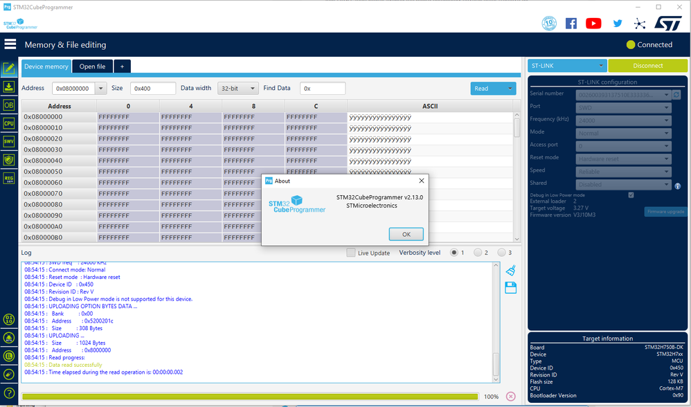

I try to connect STM32H750-DK with STM32CudeProgrammer but it shows as the picture. What should I do?

I don't reproduce this problem on my side with the latest version v2.13.0 and the same DK board.
Please follow the very good recommendations of Tesla DeLorean to erase the firmware by connecting BOOT0 IO to 3.3V (shorting solder bridge R144 on pcb).
0693W00000aIeNjQAK.pngBest regards,

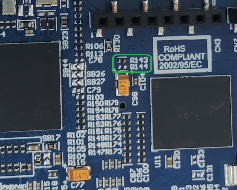

You could bridge the R144 pads with a wire, or wire some jumper or switch.
0693W00000aIiEbQAK.jpgYou should probably establish that the code you put on the board is where the problem is. As I understand the H750B-DK it uses the LDO, where as the H745I-DISCO uses the SMPS.

Connect mode: Under Reset
Reset mode : Hardware reset

I can't find where the BOOT0 pin is exactly on my STM32H750B-DK board
