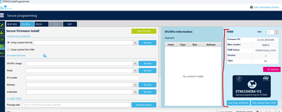

Hi, using STM32 Cube Programmer and STM32 Trusted Package Creator W2.21, I was unable to detect the HSM card, getting error 0x88000002. I had to downgrade to V2.14, as mentionned in several posts to get it detected successfully.
I use HID Omnikey 3121 reader.
Any solution to be able to use last version 2.21 and HSM card ?

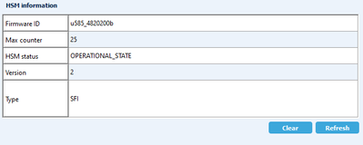

I can't reproduce the behavior you're seeing, but I don't have the exact reader you're using on hand. According to the last comment on this thread, installing STM32CubeProgrammer to a different path resolved the issue for v2.16. Could you try that and get back to me? Also, can you detect the HSM in STM32CubeProgrammer here ?

I confirm it works after I did the installation of the latest version V2.21 on a different folder. Note: I haven't uninstalled the previous version 2.14. Then both version could detect the HSM card and I could program the HSM card successfully.
