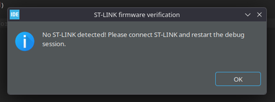

Hey all, just installed STM32CubeIDE on cachyOS and connected my HiLetGo STM32F103C8T6 dev board (https://www.amazon.com/dp/B07VKSVM21), and the IDE is giving me the following error when I try to debug or deploy:
I tried installing ST-LINK-SERVER separately just to be safe, and it said that it was already installed. (I assume as part of the Cube IDE installation.) Also reinstalled libusb (Version 1.0.29-1.1).
I can see STM32x_USB under Removable Devices in the system browser when plugged in, so I know the board is connecting at least. Any ideas here?

So do you have a ST-Link?

If you buy a knock off programmer that likely won’t work well either. The boards you bought almost certainly contain counterfeit chips. They can work, but you are rolling the dice. Consider if the discount is worth your time.
It’s generally better to stick with genuine parts. A NUCLEO-F103RB board is cheap and has a built-in ST-Link programmer.

And adding to what other posters already mentioned ...
All Linux distros I know support the ST-Link out of the box, you don't need to install any drivers.
Cachy OS is most probably no exception.
Just connect a ST-Link, and type "lsusb" in a command line.
You will need to add you user to certain groups to be able to use it, though. Normally toolchain installers do this for you, but I'm not sure about Cube, and your distro. Group names differ somewhat between Linux flavours.
Worst case you might need to do it manually.
2026-03-09 1:47 AM
Aside from the question of whether your board might have a STM chip or not, do you have a st-link at all ?
Because you wrote: > and connected my HiLetGo STM32F103C8T6 dev board < , which is just the target board, without st-link on board . Without st-link no debug connection possible . (or other, like j-link, cmsis-DAP , etc.)

Thanks, all!!
And noted, I had in fact ordered one of said colorful tin cans off Amazon yesterday after hearing that there was no ST-LINK on this board. Just cancelled that and ordered and official device directly from ST-LINK, I had no idea there was a difference so I appreciate your assistance here.
