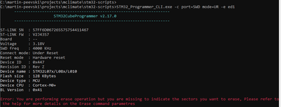

Hi all,
I have problem erasing the EEPROM from the command line. My command is:
"STM32_Programmer_CLI.exe -c port=SWD mode=UR --erase ed1"
And I get that error:
"Error: You are performing erase operation but you are missing to indicate the sectors you want to erase, Please refer to the help for more details on the Erase command parametres"
The version is STM32CubeProgrammer v2.16.0, v2.17.0.
Any idea how to make the CLI working?

Hello @Marcuka ,
Thank you for your feedback. This issue has already been raised to the dev team to resolve it.
Internal ticket number: 186569 (This is an internal tracking number and is not accessible or usable by customers)
In the meantime, you can try using the GUI of version 2.17.0 or the CLI of version 2.15.0, and I will keep you updated about any progress. Thank you for your understanding !
