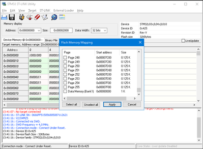

Using the old ST-LINK utility it was possible to erase the EEPROM using the Flash Memory Mapping window, shown below:
Note the entry at the bottom of the list is labeled "Data Memory (Bank1)" and is 1 KB in size. This is the EEPROM in the part.

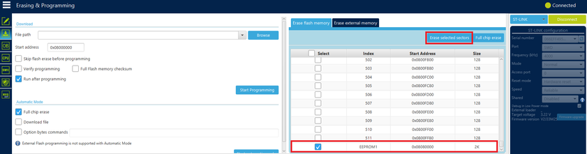

You can also use the STM32CubeProgrammer GUI to erase the internal EEPROM. Simply navigate to the 'Erasing & programming' menu, select the EEPROM bank, and then click on the 'Erase selected sectors' button.

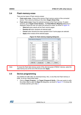

I now also looked at STLink Utility, and lo and behold, it's similar:
I then looked into STLink's User Manual, UM0892. Textual search for "eeprom" found it only once, in description of the command-line utility. However, there's also this:
So that would need to have 'L0 added, and also the word "eeprom" so that it can be searched for.

OMG!!
Thanks so much! *** me, I did not scroll all the way to the bottom of the "Erase selected sectors" screen. This is much more convenient than doing from the command line.
