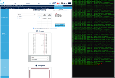

2024-12-10 1:06 AM
Hello @MPamenter ,
Let me thank you for your feedback and welcome to the ST Community.
I reproduced your request, and the 'CAD Models' download was established successfully.
Thanks.
Mahmoud
2024-12-10 9:13 AM
Hi Mahmoud,
I tried again with both KiCAD v6+ and 3D STEP enabled and the download failed with the same "AxiosError" as before. I noticed your screenshot only included the KiCAD v6+ option so I removed the STEP option and the download worked.
It appears the issue is related to the 3D STEP option.
Good enough for me! I'll download the STEP module separately from Ultra Librarian.
Thank you for your help.
Matt

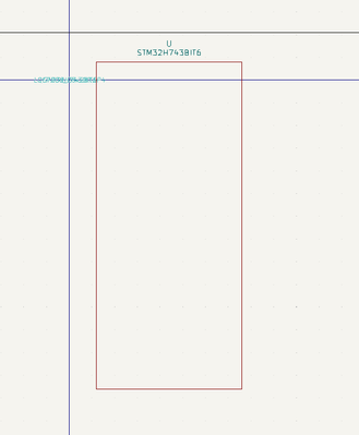

2024-12-10 9:22 AM
Hi again,
Looks like I spoke too soon. The downloaded KiCAD symbol is empty. Looks like this feature is still broken.
Matt
