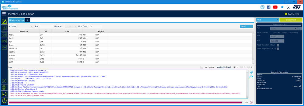

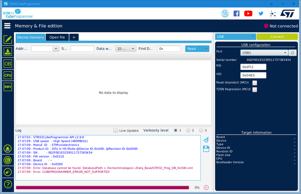

I just installed the CubeProgrammer and I'm following the Populate the target and boot the image guide. When I get to section 1.1.1.1.2.6 Populate the SDCard and click "Connect" I get this error:

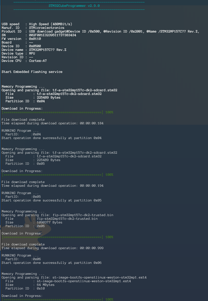

But if I execute this on the command line:
sudo /opt/st/stm32cubeprgrammer_2.9.0/bin/STM32_Programmer_CLI -c port=usb1 -w flashlayout_st-image-weston/trusted/FlashLayout_sdcard_stm32mp157c-dk2-trusted.tsvEverything works perfectly fine. I get this:
Is anyone familiar with that error on the GUI? If it works on the CLI it should work on the GUI too, isn't it?

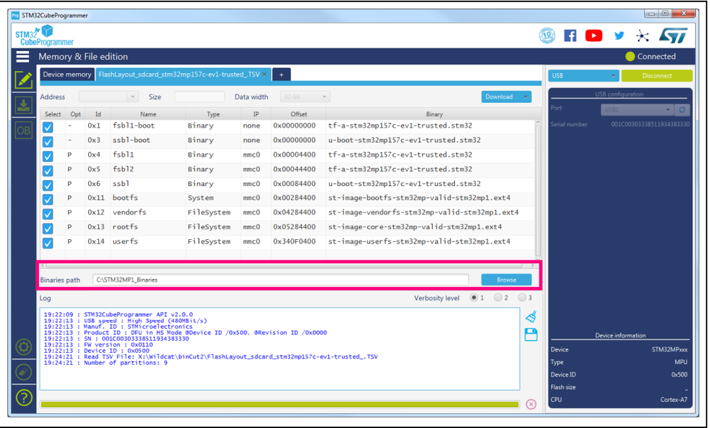

It seems that binary path is not filled with correct path, that's why CubeProgrammer still searching for an old path.
You need to give the path of binaries used as shown in screenshot below :
Can you please try and tell me if the issue is resolved?

Is there a reason you're running it in superuser mode? Are you also running the GUI in superuser mode?
Linux support on ST tools isn't awesome. Looks like it's not looking in the right folder. Unlikely that databases are stored in /home/.

I have to run it as superuser because if I don't, then neither the CLI nor the GUI can see the USB.
Yeah, that database is not stored at /home that is where I'm starting the GUI. So, it seems that I need to go to <install dir>/bin every time I need to run it? Isn't adding the bin directory to the PATH supposed to avoid this?

But now it is complaining about not finding the file I'm choosing. I don't know why it is changing the path. It says there in the blue message that is read the file
/home/mmalagon/STM32MPU_workspace/STM32MP15-Ecosystem-v3.1.0/Starter-Package/stm32mp1-openstlinux-5.10-dunfell-mp1-21-11-17/images/stm32mp1/flashlayout_st-image-weston/trusted/FlashLayout_sdcard_stm32mp157c-dk2-trusted.tsvSo I don't know why it is complaining about not finding this file:
Error: File does not exist: /home/mmalagon/STM32MPU_workspace/STM32MP15-Ecosystem-v3.1.0/Starter-Package/stm32mp1-openstlinux-5.10-dunfell-mp1-21-11-17/images/stm32mp1/flashlayout_st-image-weston/trusted/arm-trusted-firmware/tf-a-stm32mp157c-dk2-usb.stm32Why is it trying to use that file, that is not the one I have specified.
Houda

@Houda GHABRI Thanks for helping.
Yes, correcting the path solves the issue. Now it works ok.
