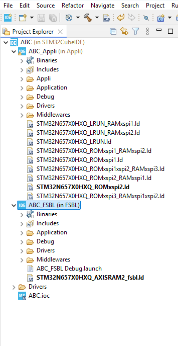

2026-04-10 4:57 AM - last edited on 2026-04-10 5:14 AM by Andrew Neil
No my code does not have any low power mode.
Below is my project structure. I have FSBL included in it but my whole project is in application main.c . Do I have to take care of any extra settings of debugger while debugging the application code?
While in this case if I try to debug FSBL first that is also not working. Which parameters should I recheck again.
From Example - GPIO toggle was working fine.

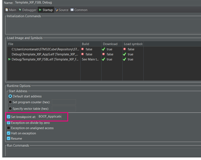

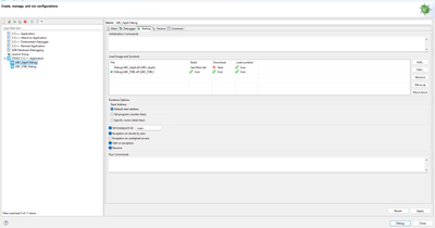

In this knowledge article at ST community, I tried loading this Template file, If I am working on my FSBL+Application project .
1) In debug configuration settings , What bin file should I use, the same which has been used in template example or from our project and how to find its address?
2) Debug as in my case should halt at main only (as I am working in main of application only)
3) Should I start debugging from FSBL or application directly ( My whole program is in application main ())
I have attached the screenshot of template page and other is my application debug configuration settings , Can you tell these two queries?

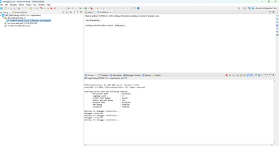

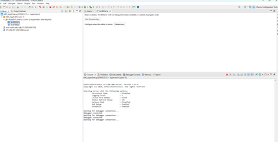

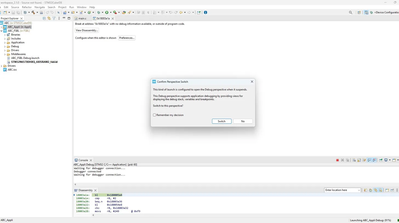

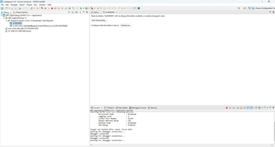

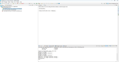

2026-04-15 11:10 PM - edited 2026-04-15 11:10 PM

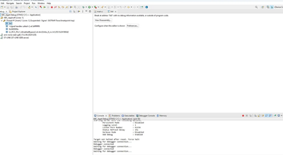

@Mahmoud Ben Romdhane I followed the article https://community.st.com/t5/stm32-mcus/how-to-build-an-ai-application-from-scratch-on-the-stm32n6570-dk/ta-p/825591 as you told, It helped in removing the Target unknown error 32, But I am still stuck as when I debug application it jumps to somewhere outside the code. I know less about memory mappings of STM32N6, Can you help? I am attaching fours steps that is happening while debugging of application.
