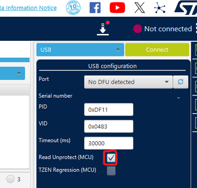

2025-12-03 7:58 AM
Hello @MSSloan1962,
You can disable RDP 1 by a debug connection (ST-Link or JLink) or by the read unprotect command via bootloader interfaces :
Could you detail the case where RDP was set to 1 ? Can you reproduce it with your API project, if yes please share your code and detailed steps to reproduce.
Aziz
