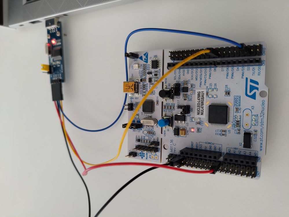

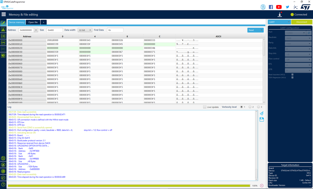

@newbie_stm32 Some success?
Look at my settings:
You have simmilar board. try use jumper to connect. My result:

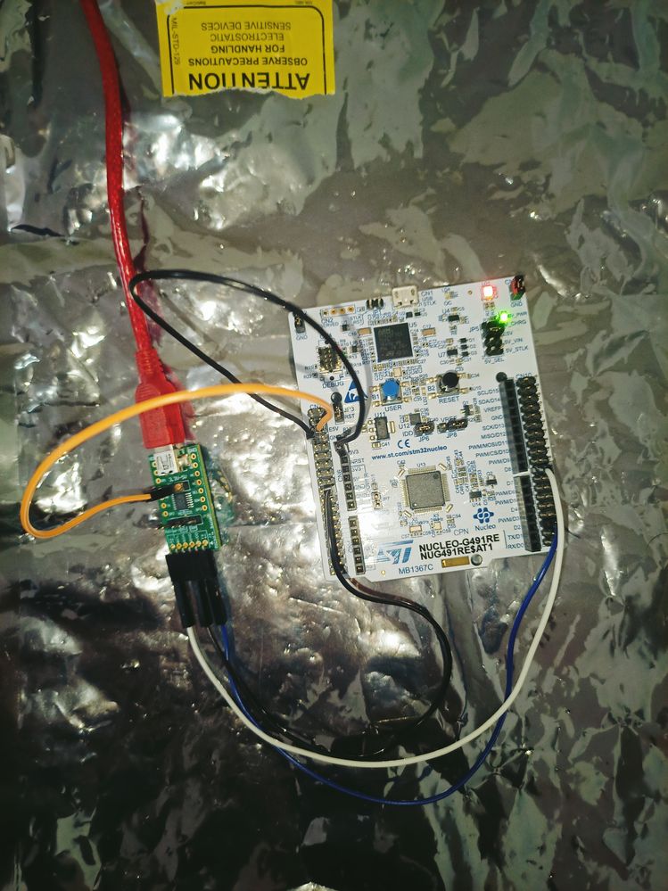

Hi @Kamil Duljas, it did work for me. But when I tried it one more time, I got the same error message as shown before. I can assure you that connecting the BOOT0 pin to 3V3 and pressing RESET is keeping the MCU in the boot from system memory as there is blink code flashed to MCU with which after pressing RESET is not executing.
PS: I flashed using the system bootloader and immediately after that without disconnecting BOOT0 pressed RESET. After which I am not able to flash again using the system bootloader.
2023-05-03 2:04 AM
Show me your connections
2023-05-03 2:17 AM - edited 2023-11-20 7:13 AM
Here it is
2023-05-03 2:20 AM
Try use only 4 cables. Tx Rx gnd vdd from green pcb
2023-05-03 2:23 AM
It's 4 only rather than connecting it to VDD (orange cable), I connected it to 5V at jumper.
2023-05-03 2:32 AM
Ok so now, what's the problem? I'm lost :D
