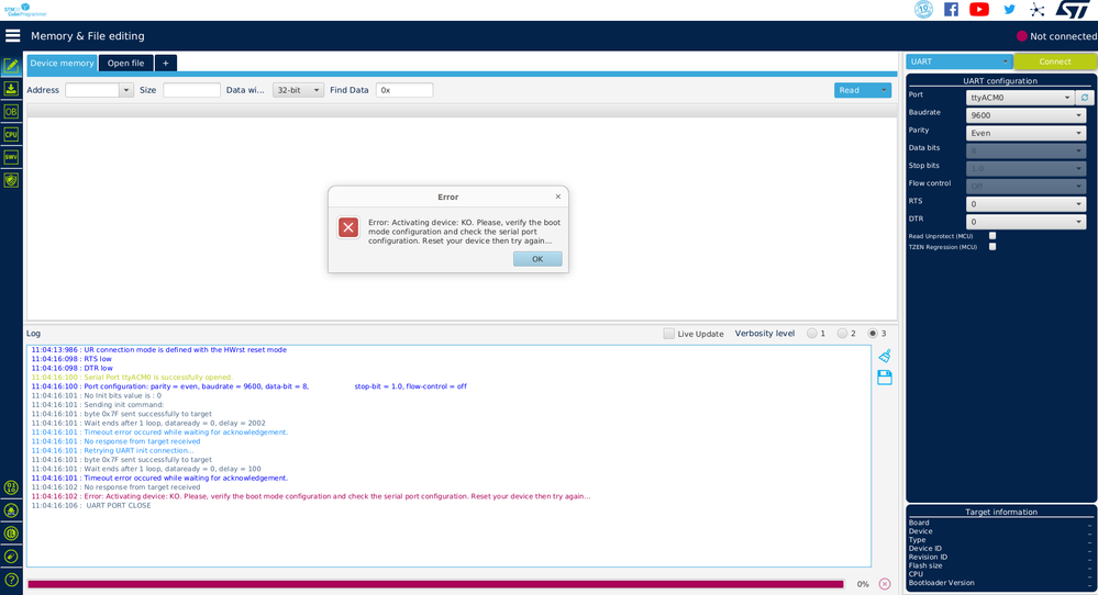

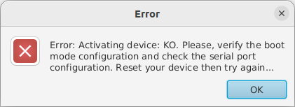

}But once the User Button is pressed and tried to connect to the UART interface using STM32CubeProgrammer it shows
Why is the firmware upgrade not working?

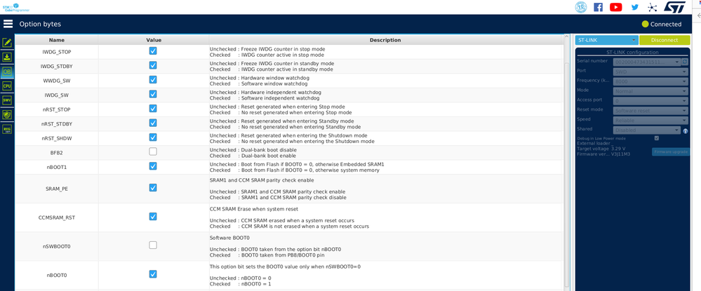

2023-04-25 10:13 PM - edited 2023-11-20 7:13 AM
Hi, @mm..1 I have already followed this and changed them using STM32CubeProgrammer using the ST-LINK option. I have opted for the first option on Pattern 15.
Please find those here, correct me if I have missed something.
