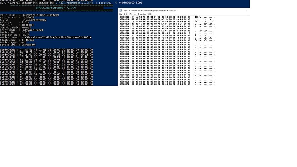

}I erase the board (validating 0x08000000 is 0xFF, 0xFF...).
Now I flash my ELF:
STM32_Programmer_CLI.exe -c port=SWD -d .\build\TestAppMin.elfLooking at address 0x08001000 - the application data is correct.
But, looking at address 0x08000000 I don't have 0xFF anymore... I have the beginning of the ELF file - see image:

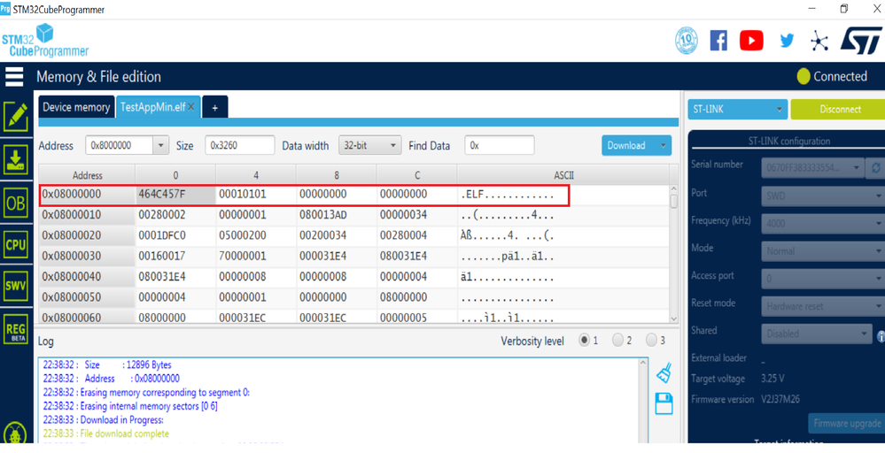

Hi @Community member ,
The elf file you sent is starting from address 0x8000000 so it is normal to have such result (data in address 0x8000000).
It seems that address is not modified in your efl file to 0x08001000.
Can you please regenerate the elf file and check the start address in CubeProgrammer GUI?

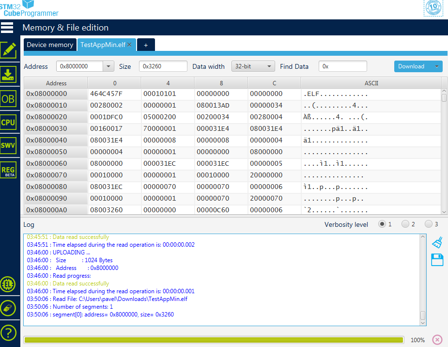

@Community member There's something strange. The elf file should be converted to binary before writing to flash - but in your case it isn't.
Instead of "ELF" signature at 0x08000000 you should see the vectors at your start address 08001000.
When CubeProgrammer opens an elf file, debug messages in the log window should confirm that it correctly parsed the file,
detected code and data sections addresses.
For your file, I see this:
So it looks like CubeProgrammer failed to find the text section.

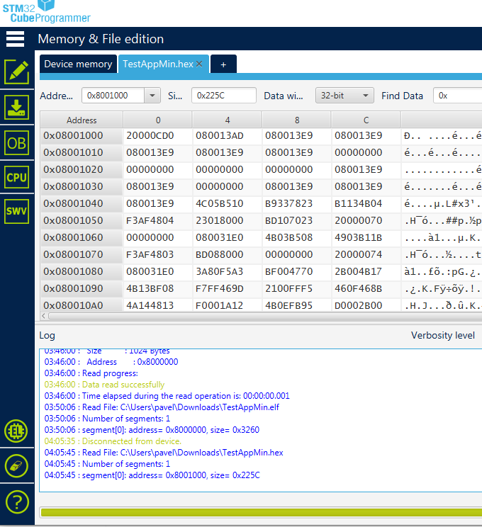

The hex file parses correctly:
-- pa
(tested on ver. 2.6.0)
