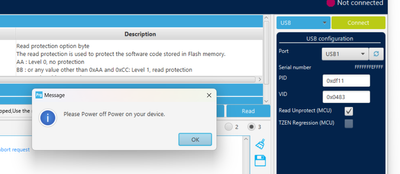

When I try to unlock it using the CubeProgrammer, I either get an error saying the device is read protected or that I need to power cycle the device, but still won't connect.

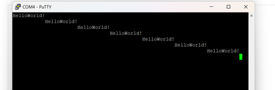

I have also confirmed that the USB connection is fine by simply printing "HelloWorld!" to a putty console.
