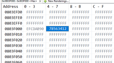

My code is
uint64_t data=0x1234567890ABCDEF;
HAL_FLASH_Unlock();
HAL_FLASH_Program(FLASH_TYPEPROGRAM_DOUBLEWORD,0x0803F000,data);
HAL_FLASH_Lock();
The data have been stored in the desired address. My doubt is, as per the manual I didn't set PG bit and check any status of the flash register but I got an output how?

Hello @ajimathew ,
You have already set the PG bit.
Because when you are calling HAL_FLASH_Program(FLASH_TYPEPROGRAM_DOUBLEWORD,0x0803F000,data); the PG has been set.
static void FLASH_Program_DoubleWord(uint32_t Address, uint64_t Data)
/* Check the parameters */
assert_param(IS_FLASH_PROGRAM_ADDRESS(Address));
/* Set PG bit */
SET_BIT(FLASH->CR, FLASH_CR_PG);
/* Program first word */
*(__IO uint32_t*)Address = (uint32_t)Data;
/* Barrier to ensure programming is performed in 2 steps, in right order
(independently of compiler optimization behavior) */
__ISB();
/* Program second word */
*(__IO uint32_t*)(Address+4U) = (uint32_t)(Data >> 32);
