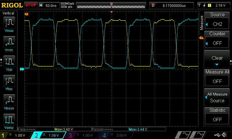

My first guess was a hardware issue, so I used an oscilloscope to measure if there's any interference on the D+ and D- lines leading to the MCU pins, but based on my observation the signal looks fine and pretty much the same as on the Nucleo. On my design the D+ and D- are short, run along side each other and have an uninterrupted ground plane beneath them.

Hi @MLovr.1
I tested with two chip revision ID 0x1003 (revY) and 0x2001(revX) , for both revisions download is OK with STM32CubeProgrammer v2.4.0.
I made a check with exactly same file size than you.
My conclusion : It is not a STM32CubeProgrammer issue , it seems to be a Hardware issue.
