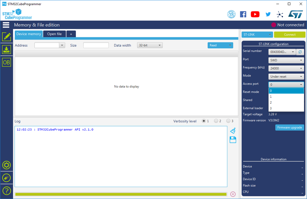

Hi guys, I disabled flashing core M7 in STM32CubeProgrammer option bytes to run just M4, but now I cant connect to the board and the tool says Error: No STM32 target found!. Is there some possibility how to reset the option bytes to again run M7?

Hi @binarybee
Core M7 is connected to access port 0, Core M4 is connected to access port 3.
Since you disabled core M7, choose access port 3 in STM32CubeProgrammer to connect to M4, then you can reset the option bytes to again run M7.

2020-05-07 6:28 AM
Hi I tried it with port 3 but its still the same problem.

Hi @binarybee
There is a limitation on Cube Programmer it will be fixed in next release, as alternative today you can use st-link utility.

2020-05-08 4:56 AM
Hi yes I jumped to that limitation probably, with st link utility it worked and I can again reach M7 core.
