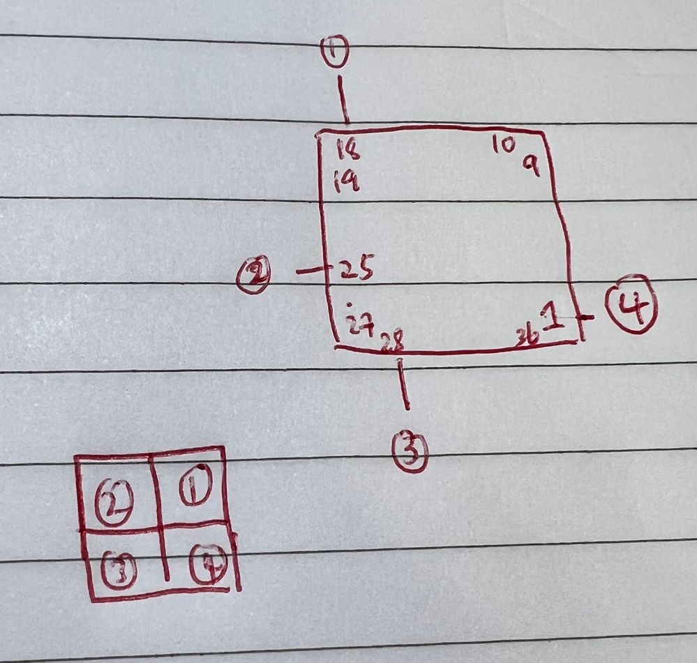

An update. Turns out I made the rookie mistake of using a faulty probe. After changing the probe, I was able to deduce the following:
Socket 1 = Pin 18 of microcontroller
Socket 2 = Pin 25 of microcontroller
Socket 3 = Pin 28 of microcontroller
Socket 4 = Pin 1 of microcontroller
Again the solder traces were tiny so there might be a mistake, but this corresponds to:
VDD_1, VSS_1, PA13, PA14. (ie, power, ground, SWDIO, SWCLK)
Would that make sense?

@BTay.1 "the solder traces were tiny"
LOL - those traces are huge by modern standards! :face_with_tears_of_joy: :grinning_face_with_sweat:
"(ie, power, ground, SWDIO, SWCLK) Would that make sense?"
Yes, that's exactly what you'd need for an SWD programming/debug connection
(it'd be nice to also have Reset, but not essential).

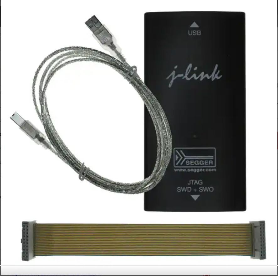

In addition every Nucleo-64/144 board has an onboard ST-LINK that can be used as a debugger probe for other boards.
Another popular choice is SEGGER J-Link devices.
2022-07-05 8:15 PM

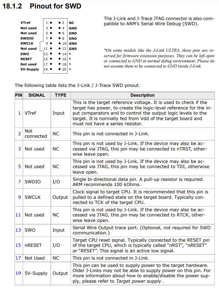

Thank you for the suggestion, I am looking at:
So I can connect this to the STM32CubeProgrammer, using that?
I have to manufacture a cable linking:
Socket 1 = Pin 18 of microcontroller = VSS_1 = GND (pins 4,6,8,10,12 of ribbon cable)
Socket 2 = Pin 25 of microcontroller = SWDIO = Pin 7 of ribbon cable
Socket 3 = Pin 28 of microcontroller = SWDCLK = pin 9 of ribbon cable
Socket 4 = Pin 1 of microcontroller = VDD = pin 1 of ribbon cable
That would work, I hope.
2022-07-05 11:38 PM
No. More detailed answer:
https://community.st.com/s/question/0D53W00001SdsrCSAR/cubeprogrammer-with-jlink
In addition to CubeIDE supporting J-Link, you will have these:
https://wiki.segger.com/UM08001_J-Link_/_J-Trace_User_Guide#J-Link_Software_and_Documentation_Pack
As far as I understand, CubeIDE has an integrated J-Link GDB Server. I don't understand why they don't just call the normally installed J-Link GDB Server like some other IDEs do, but hey - we're talking about ST's software...
