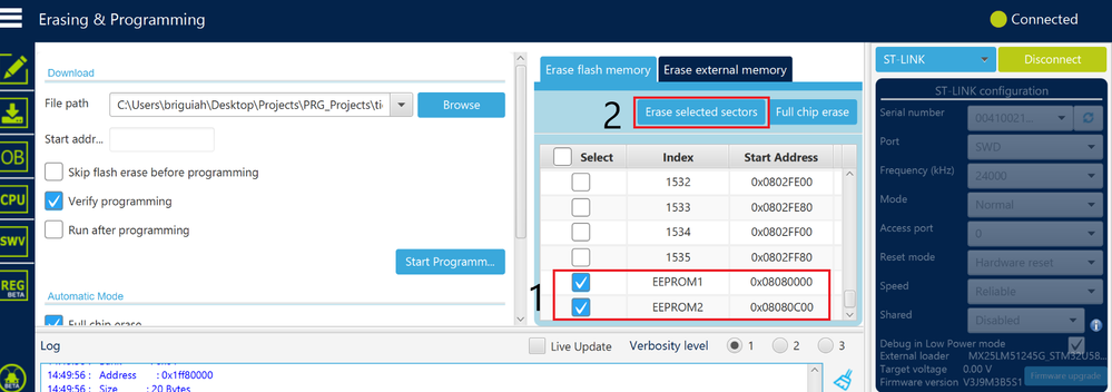

Hello @Community member,
Thank you for posting,
You can use STM32CubeProgrammer to erase the internal EEPROM, simply connect to your device, then through the "Erasing & programming" menu, select EEPROM banks then click "Erase selected sectors"
Let me know if this solves your issue.

2022-06-28 6:54 AM

2022-07-06 9:26 PM
Thank-you Aziz - it does solve my issue, and apologies also for not getting back to you much sooner.
