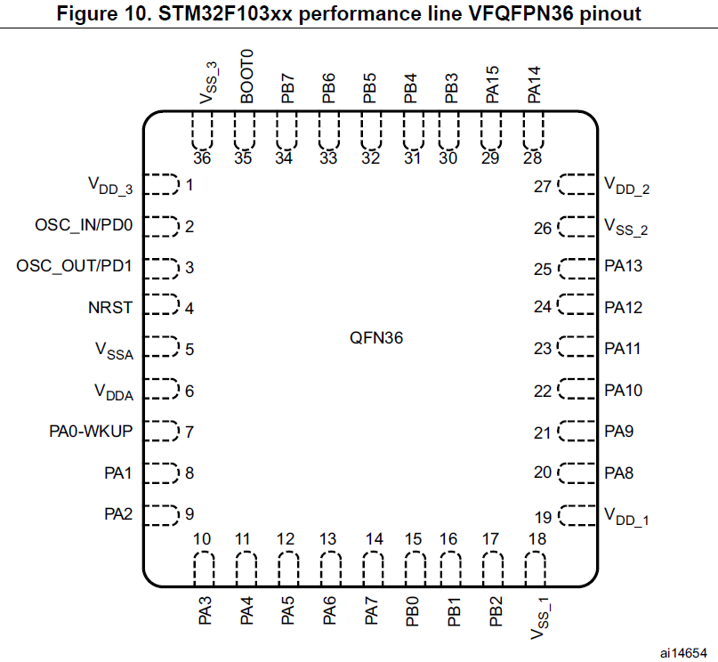

2022-06-29 11:34 PM
Hey JW, thanks for your reply and I am sorry for my late response. Those pins you highlighted correspond to the VFQFPN36 package, but the one I see on the board has 36 physical legs, meaning it can only be a LQFP package, but the min. number of legs for the LQFP packages stated on the datasheet goes only to 48. This is why I am confused as to which of the 36 pins correspond to the JTAG lines.
2022-06-30 12:15 AM
You're overthinking this, it's not that complicated.
STM32F103T8U7
UFQFPN-36
https://www.mouser.com/datasheet/2/389/stm32f103c8-1851025.pdf
PA13 JTMS/SWDIO
PA14 JTCK/SWCLK
PA15 JTDI
PB3 SWO/TDO
PB4 JNTRST

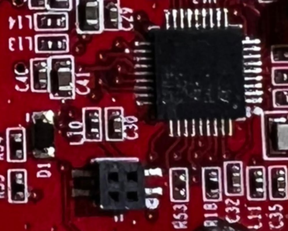

2022-06-30 2:00 AM
So as you can see it is 36 legs, 9 legs on each side, and the 4 pin header (i believe it's use for programming). Tried probing but didnt have much success so far.
2022-06-30 2:11 AM
@BTay.1 "the 4 pin header (i believe it's use for programming)"
You "believe"?
What have you done to confirm that belief?
If it's only 4 pins, unlikely that it'll be JTAG.
But it might be a UART or other bootloader...
"Tried probing but didnt have much success so far"
you're the only one that has the board - so nobody can help you with that.
I'd start by getting some decent high-resolution images of both sides of the board.
You may need to invest in a better camera (or a camera with better macro capability).
Sometimes a flatbed scanner can be good for this - if other components aren't too tall.
Use an image-processing tool to reverse the image of the back side of the board - so that it corresponds to the front image.
Then you can trace the tracks, and see where vias join layers...

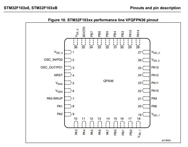

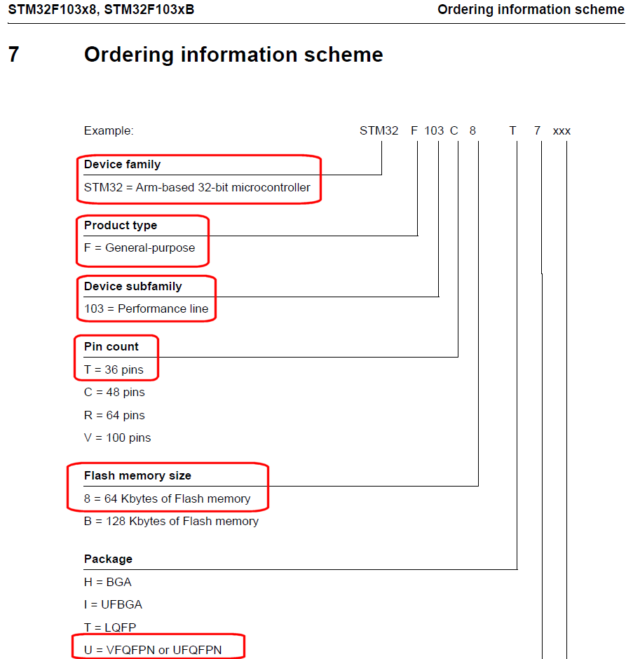

@BTay.1 "part marking: STM32F103T8U77BA7E93PHL739"
The datasheet for that says:
So that part number is for either a VFQFPN or a UFQFPN:
Neither of those matches the image you posted so, as @Community member said, it looks like you've mis-read the part number.
Or it's a fake part ...
EDIT
@Piranha and @Community member have pointed out that it is (or could be) a QFN, but with PCB pads that would also take a QFP.
2022-06-30 5:33 AM
Power, ground, and crystal seem to be well situated.
You're telling me you can't probe out two signals, or add some flying leads to SWDIO/SWCLK?
The photography is pretty poor, something crisp and in-focus would be good, but still are we sure this is pinned, and not just using very long, QFP compatible, land patterns and a boat loads of solder?
