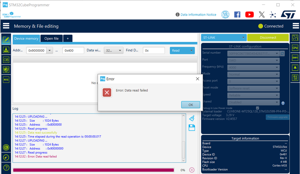

The cube programmer only tells me "Error: Data read failure".
I realized that if I return early from the Init, no error is issued and the flash only read zeros - which makes sense because the ospi is not initialized yet.
Thus I found out that the issue so far is on HAL_OSPI_MspInit function that was generated by cubemx.

I found the issue that I was having :)
For some reason the stm32programmer was calling the Init() function multiple times, and on the second run it crashed.
I solved the issue by testing whether the ospi was initialized or not
