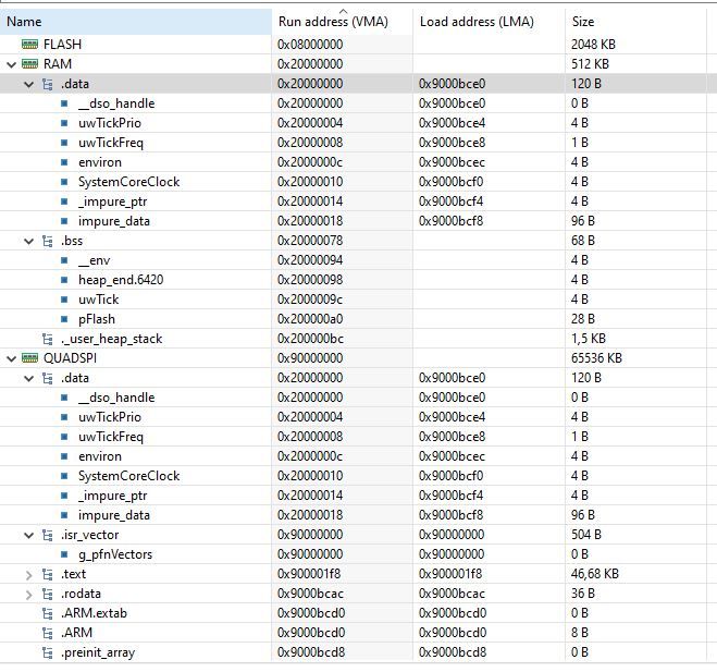

I modified my .ld file as:
MEMORY
RAM (xrw) : ORIGIN = 0x20000000, LENGTH = 512K
FLASH (rx) : ORIGIN = 0x8000000, LENGTH = 2048K
QUADSPI (rx) : ORIGIN = 0x90000000, LENGTH = 64M (added line)
And I replaced FLASH with QUADSPI in order to load all to external flash.

#endifWhen I debug the program with STM32CubeIDE
with external loader (MX25L512G_STM32F769I-DISCO, 0x90000000, NOR_FLASH, MX25L512G_STM32F769I-DISCO.stldr) my program reaches 0x90000000 and executes the code.
When I reset program (e.g. by button) or try to download program with STM32 ST-LINK Utility or STM32CubeProg... my program does not start.

I found QSPI_PreInitConfig example. It is not exactly what I need, but it seems that they initialize QSPI interface and then execute a code from 0x90000000. The readme contains text:
How to configure the QSPI IP in order to have access to external memory just after reset.
This example describes how to execute a part of the code from a QSPI memory. To do this,
a section is created where the function is stored.
The QSPI is configured in memory-mapped mode before to call main() function and QSPI memory
is then available after the reset.
